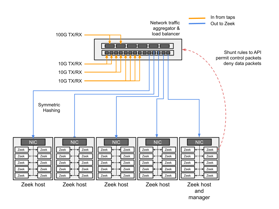

Cluster Framework
The basic premise of Zeek clusterization is to break down network traffic into smaller pieces, while preserving the affinity of individual network sessions to a single analysis process. Cluster architecture thus allows Zeek to distribute that analysis across many dozens or hundreds of worker processes, allowing the monitoring system to scale up to line speeds of 100G or more.
Figure 1: Block diagram of cluster setup showing multiple network feeds to a traffic aggregator. This device sends traffic to workers after symmetric hashing/load-balancing. Traffic is then fed to the Zeek cluster using load-balancing network cards.
Zeek’s Cluster Components
By distributing network traffic across hosts and processes, overall traffic finally reaches a volume that can be effectively analyzed by a single worker process. Zeek then acts as a distributed network security monitor to perform analysis across many dozens or hundreds of workers, all acting on a small fraction of the overall traffic volume. The analysis of the worker process is further facilitated by nodes such as manager and proxies, ultimately logging the alerts and or relevant network logs. A Zeek cluster therefore consists of four main components: a manager, workers, proxies, and a logger.

To set up a cluster we need a network-aggregator/load balancing device which can aggregate inputs from network sources, such as taps or span ports. This device also performs the critical function of ensuring each TCP session is distributed to a single link. This function is provided through symmetric hashing.
Once the tap aggregator is set, output from each port is sent to a “Zeek node” which is typically built on commodity hardware. Zeek clusters have evolved from running the manager, workers and proxies on individual servers, to most often now running a “cluster-in-a-box” setup, where a powerful multi-core box with dedicated cores hosts the workers, proxies logger and manager. We’ve seen instances of 90 workers running on a single physical server.
At present the preferred way to run a cluster is to use a load-balancing network card such as Myricom NICs or Intel cards with PF_RING or AF_PACKET support. The NIC (and associated software) further divides the traffic to multiple Zeek worker processes running on the ‘Zeek- node’.
While the Zeek cluster allows us to monitor traffic at scale, an optional add-on technology called “shunting” is helpful to reduce the volume that needs be processed.. Shunting can detect specific large data flows based on predetermined characteristics and communicate with the network tap via an API to stop sending those flows to Zeek for analysis. This allows Zeek to maintain awareness and logs of these shunted large flows while dramatically reducing the analysis load necessary to process traffic.
