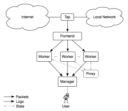

A Zeek Cluster is a set of systems jointly analyzing the traffic of a network link in a coordinated fashion. You can operate such a setup from a central manager system easily using ZeekControl because it hides much of the complexity of the multi-machine installation.
Cluster Architecture
Zeek is not multithreaded, so once the limitations of a single processor core are reached the only option currently is to spread the workload across many cores, or even many physical computers. The cluster deployment scenario for Zeek is the current solution to build these larger systems. The tools and scripts that accompany Zeek provide the structure to easily manage many Zeek processes examining packets and doing correlation activities but acting as a singular, cohesive entity. This document describes the Zeek cluster architecture. For information on how to configure a Zeek cluster, see the documentation for ZeekControl.
The figure below illustrates the main components of a Zeek cluster.
_images/deployment.png
For more specific information on the way Zeek processes are connected, how they function, and how they communicate with each other, see the Broker Framework Documentation.
Tap
The tap is a mechanism that splits the packet stream in order to make a copy available for inspection. Examples include the monitoring port on a switch and an optical splitter on fiber networks.
Frontend
The frontend is a discrete hardware device or on-host technique that splits traffic into many streams or flows. The Zeek binary does not do this job. There are numerous ways to accomplish this task, some of which are described below in Frontend Options.
The manager is a Zeek process that has two primary jobs. It receives log messages and notices from the rest of the nodes in the cluster using the Zeek communications protocol (note that if you use a separate logger node, then the logger receives all logs instead of the manager). The result is a single log instead of many discrete logs that you have to combine in some manner with post-processing. The manager also supports other functionality and analysis which requires a centralized, global view of events or data.
A logger is an optional Zeek process that receives log messages from the rest of the nodes in the cluster using the Zeek communications protocol. The purpose of having a logger receive logs instead of the manager is to reduce the load on the manager. If no logger is needed, then the manager will receive logs instead.
A proxy is a Zeek process that may be used to offload data storage or any arbitrary workload. A cluster may contain multiple proxy nodes. The default scripts that come with Zeek make minimal use of proxies, so a single one may be sufficient, but customized use of them to partition data or workloads provides greater cluster scalability potential than just doing similar tasks on a single, centralized Manager node.
Zeek processes acting as proxies don’t tend to be extremely hard on CPU or memory and users frequently run proxy processes on the same physical host as the manager.
The worker is the Zeek process that sniffs network traffic and does protocol analysis on the reassembled traffic streams. Most of the work of an active cluster takes place on the workers and as such, the workers typically represent the bulk of the Zeek processes that are running in a cluster. The fastest memory and CPU core speed you can afford is recommended since all of the protocol parsing and most analysis will take place here. There are no particular requirements for the disks in workers since almost all logging is done remotely to the manager, and normally very little is written to disk.
