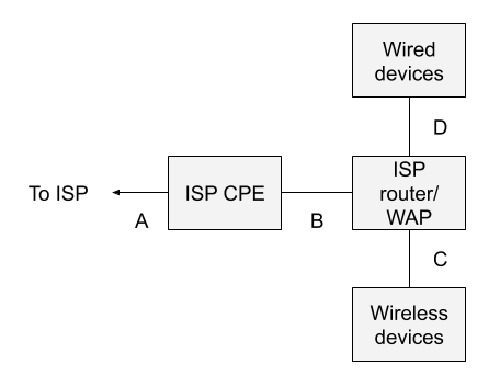

Users new to Zeek may choose to try Zeek in their home or in a small office environment. Figure 1 depicts the standard SOHO network architecture. Letters A-D are possible monitoring locations, to be discussed below.
_images/collection-figure1.png
Figure 1: Standard SOHO Architecture
Most home users and many small office environments are connected to the Internet via customer premise equipment (CPE) provided by their Internet service provider (ISP). This box may or may not be available or visible to the customer. In the context of a system like Verizon FIOS, for example, the ISP CPE is the box attached to the outside of a residence, with a warning that only Verizon technicians should open it. For fiber connectivity, the ISP might call this device an Optical Network Terminal or ONT.
The ISP also provides a gateway device that provides routing and wireless access point (WAP) functionality. This is the piece of equipment familiar to most home and small office users. It typically has a gigabit copper Ethernet connection that connects to the ISP CPE, on its wide area network (WAN) side, and four gigabit copper Ethernet ports for devices on its local area network (LAN) side. Customer devices gain network access via WiFi to the ISP WAP or via copper Ethernet cables to the embedded switch on the same device.
On the WAN side of the router, the device usually has a public IP address provided by the ISP. This may not necessarily be the case, however. On the LAN side of the router, the device provides RFC 1918 private addresses, often in the 192.168.0.0/16 subnet. The router acts as a gateway, using network address translation (NAT), or for the more strictly minded, network port address translation (NPAT), so that client devices share a single IP address provided by the ISP. (Note that in some situations, multiple residences even share the same public IP address, and differentiate between each other via the port range. We’ll not consider this further for now, as it is extraneous to the discussion.)
Where does one monitor, given this architecture?
Location A is off limits to the customer. It is likely a cable exiting the ISP CPE and entering the ground.
Location B is a possibility, assuming the cable between the ISP CPE and router is a copper Ethernet cable. One could insert a reliable network tap (typically outside the home user’s budget) or a decent small managed switch with a span port (like a Netgear GS30Xe model).
However, and this is crucial: because of the NAT done by the router, all traffic will appear to originate from a single IP address. Whether the customer has 100 devices or 1 device, they will all share the single IP address. This reality makes it much more difficult for a security analyst to track down the originator of suspicious or malicious network traffic.
Location C is essentially not possible. Yes, there are various penetration testing tools and wireless network troubleshooting tools that can try to access WiFi traffic. However, they do not expose the traffic in a form usable to security analysts, assuming that the WiFi protocols in use are at all modern.
Location D is a possibility, assuming that the user installs a network tap or switch span port as in location B. However, monitoring only at location D would ignore WiFi traffic.
In other words, the standard SOHO network architecture is not well-suited for network security monitoring, because there isn’t a good place, by default, to see the originating IP addresses, which are generally needed to investigate suspicious and malicious activity.

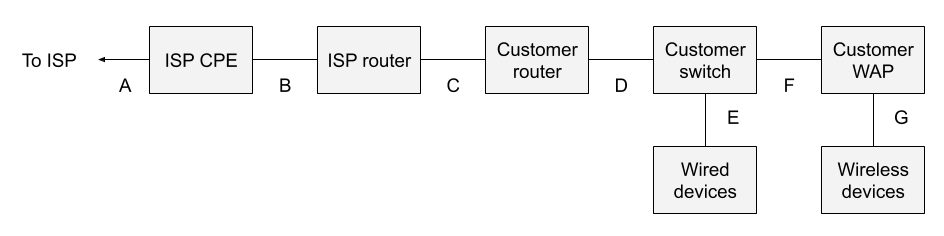

In contrast, the Visible Network Architecture shown in Figure 2 depicts the sort of setup one needs if visibility is designed into the architecture, rather than added as an afterthought.
_images/collection-figure2.png
Figure 2: Visible Network Architecture
The major changes include the following:
The ISP router is no longer also acting as a WAP. The WiFi capability is disabled. No other changes are required on the router. Strictly speaking, WiFi need not be disabled, so long as no one uses it.
The customer has purchased her own router. That device may or may not also provide NAT.
The customer explicitly owns a switch, to which wired devices may connect. That switch has a span port.
The customer explicitly owns her own wireless access point, acting as a bridge, and not offering NAT.
Don’t be fooled into thinking that one need only buy a new combination router/WAP. It’s essential to split these functions. Consumer-grade customer routers do not offer span ports, which cheap consumer-grade network switches do. This architecture takes advantage of that fact in order to provide suitable monitoring locations.
Let’s review the options.
Location A is still off-limits.
Location B is still a bad idea.
Location C is a good option, if one places a network tap here, or another small switch with a span port, and neither the customer router nor customer WAP is doing NAT.
Location D is a better option. Now one need only ensure that the customer WAP is not doing NAT. In fact, one need not introduce another switch or tap here, assuming one can span the uplink port on the customer switch.
Location E would only see wired devices, and is not a good option because it ignores WiFi devices.
Location F would only see WiFi devices, and is not a good option because it ignores wired devices.
Location G is essentially impossible, as with Figure 1.
The bottom line is that the location D is the best monitoring location, assuming that the customer WAP is not doing NAT. If the customer WAP is acting as a router with NAT, then all of the wireless devices will have the same source IP address as seen in location D.
In an architecture designed for visibility, introducing a network tap, or simply spanning the uplink from the network switch, at point D, satisfies the visibility requirement.

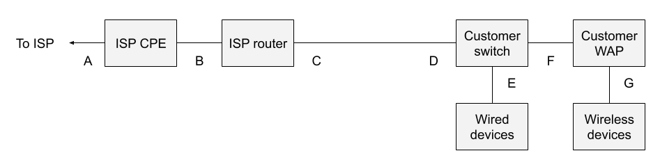

It is possible to simplify the architecture shown in figure 2 to that which follows:
_images/collection-figure3.png
Figure 3: Simplified Visible Network Architecture
The customer router between monitoring points C and D is gone, as one can rely upon the ISP router if so desired.
In summary, one could deploy a Zeek sensor at location D, or C, if the simplified architecture is in place, as C and D are logically similar. Going forward, we’ll discuss monitoring at location D.
